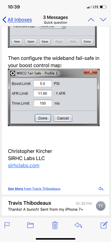

"The Cortex EBC Complete Kit includes everything required for a full controller installation on most vehicles. This kit is intended for those who are installing a turbo on a previously naturally aspirated engine or who require a boost control solenoid, hose, fittings, etc. for a complete installation."
https://sirhclabs.com/product/cortex-ebc/
Aiheesta keskustelua Corvettefoorumilla:
https://www.corvetteforum.com/forums...t-control.html
Tää vois olla kätsy kanssa tuossa Cortexissa, eli seoksen ja ahtopaineen seuranta sekä niille fail safet (jos vaan onnistuu C5:ssa):
https://www.ls1gto.com/threads/corte...ar-ebc.841243/
