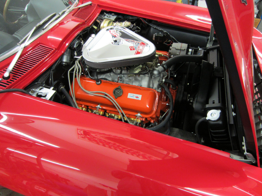

The car is a 1967 Corvette convertible.
All of the runs were made with the factory 1967 tri-power intake manifold, factory cast iron exhaust manifolds, a custom fabricated 3” exhaust system, all accessories connected (including clutch fan), and power steering.

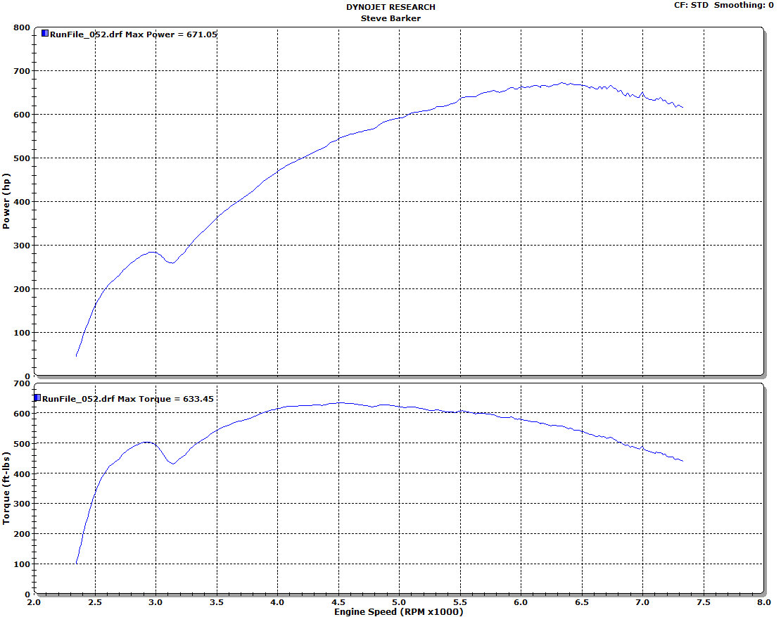

Here are the numbers from the DynoJet:
STD: 671.05 rwhp / 633.45 rwtq
SAE: 652.77 rwhp / 616.20 rwtq
Uncorrected: 671.87 rwhp / 634.23 rwtq
Some of my friends want to know what that equates to in flywheel horsepower. I hear a lot of people talk about 15%-20% for manual transmission cars.
If you take 15% the numbers become the following:
STD: 789.47 flywheel hp / 745.24 flywheel tq
SAE: 767.96 flywheel hp / 724.94 flywheel tq
Uncorrected: 790.43 flywheel hp / 746.15 flywheel tq
If you take 20% the numbers become the following:
STD: 838.81 flywheel hp / 791.81 flywheel tq
SAE: 815.96 flywheel hp / 770.25 flywheel tq
Uncorrected: 839.84 flywheel hp / 792.79 flywheel tq

For any purists out there, I am not trying to pass the car off as an original 435 hp 427 Corvette. It is a 327 car pure and simple. I will freely admit this to anyone who asks. The more I thought about trying to make a tri-power setup produce big numbers, the more I wanted the challenge. Making this combination run with factory exhaust manifolds just added to the challenge.
My goal with this combination is to have it appear factory correct under the hood. I also happen to have a 1967 Corvette coupe with a 632" motor that looks nothing like stock under the hood. I wanted to do something different this time. I have taken a great deal of time trying to make things appear stock. Most everything for this conversion was purchased from Paragon Corvette Reproductions.
This car originally came with a 350 hp 327. I put a 383” motor in it around January of 2006. With cast iron exhaust manifolds and 2-1/2” exhaust, that motor made 416.47 rwhp / 430.4 rwtq and went 11.93 at 114.99 mph in the quarter. (BTW, the 383” motor is for sale.)
The gold color you see on the top of the exhaust manifolds are a result of the exhaust manifold paint I purchased from Paragon. I painted the entire exhaust manifold with this product. It starts out gold and then as they heat up they change to a cast iron color. Since the temperature of the exhaust manifold is lower the closer you are to the exhaust flange of the head, the longer it will take to change colors.
The motor consists of the following: Chevrolet Bowtie block, Dart *highly disguised* 335 CNC heads, Jesel valvetrain, Mike Jones solid roller cam, Isky EZX roller lifters and valve springs, BRC crank, Howards I-Beam rods, J&E pistons, Total Seal rings, Clevite 77 bearings, Dan Olson oil pan, Holley fuel pump, and a trio of *SPECIAL* Holley 2-barrel carburetors.
I have made 52 DynoJet runs to get to this point. My first run was on October 20th, 2011 and the final run was on November 20th, 2011. I have tried everything within reason including moving the cam timing 4 separate times. I am not talking about ignition timing here. Anyone who has moved the cam timing on a motor that doesn’t have a belt drive while the motor is in the car can attest to the amount of work it requires. The entire front end of the motor has to come off every time.
The cam specs are 254*/258* @ .050", .701"/.700", 114 LSA. It sounds as close to the stock cam in a 435 hp 427 as myself and a couple of friends can remember. Nothing radical in any way, shape, or form. This thing is shockingly smooth.
